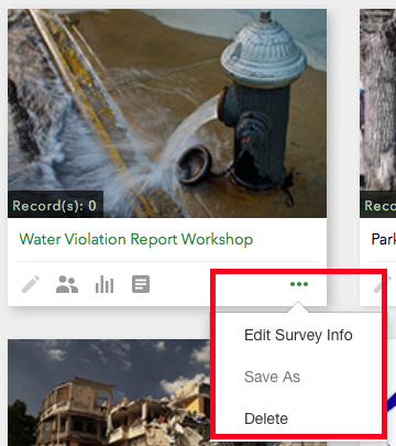

on a ipad how can i delete a published survey
JamesTedrick
Esri Esteemed Contributor
Hi Jevita,
The instructions posted above are how to remove a survey rom the device.  If you want to delete a survey entirely (not just on the device, but also delete the form and tables created), you can go to https://survey123.arcgis.com and delete it from there - the options menu for the survey has a 'Delete' entry:
