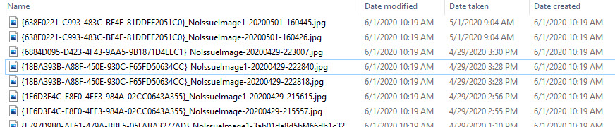

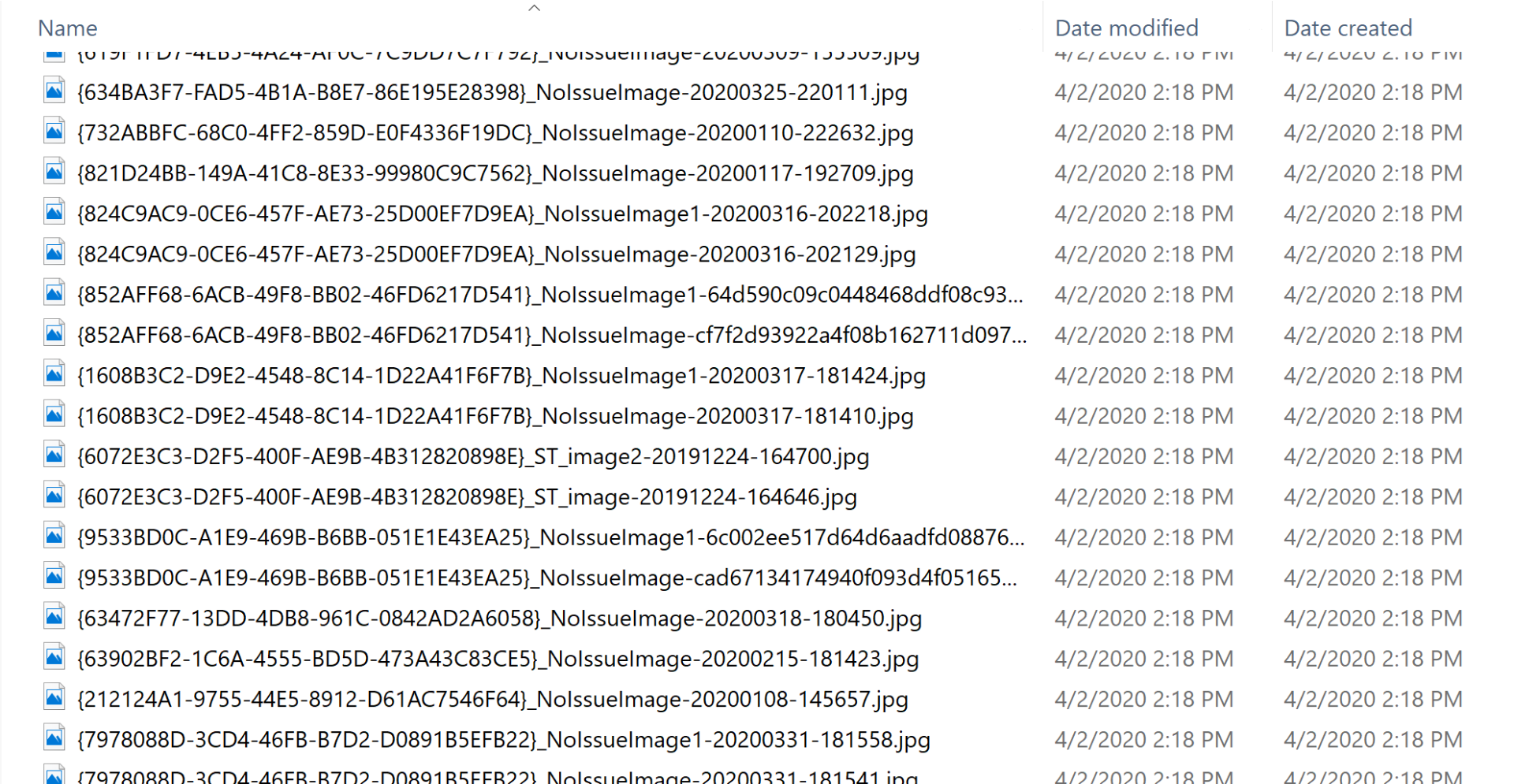

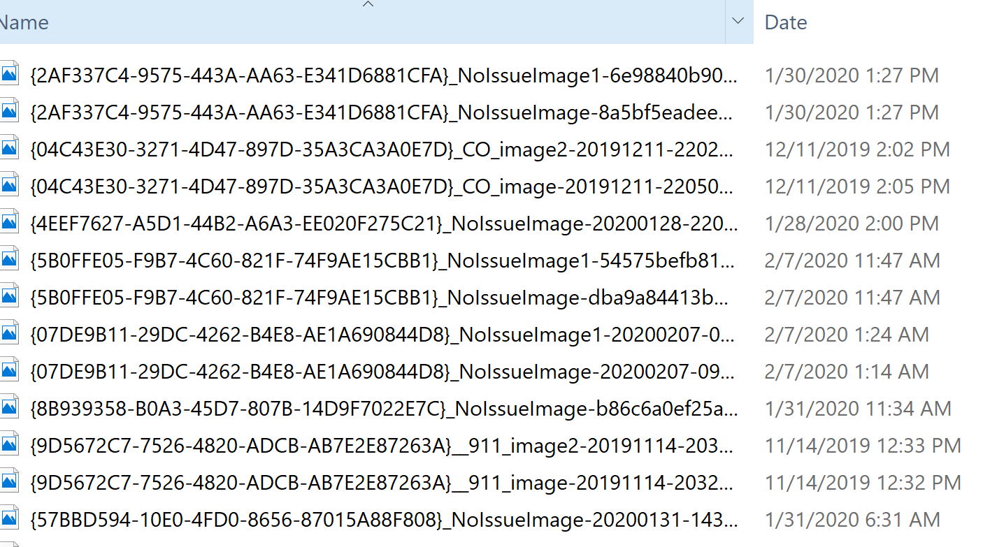

This isn't normal, something has changed in the last month.
I run a Python script to extract the photos, and these dates should be the date is taken, which helps me eliminate the oldest photos, but this is what I see in April.
Last month I saw this, PLEASE help.

When I manually download the images, the created date and the modified date are today's date and time.

MichelleWilliams1
Thanks to my 17-year-old for sharing WHY my dates weren't correct. I hope this will help others.
The last Windows update reset my headers and removed my Date Taken header. I didn't realize that Date Created wasn't the actual date created.
