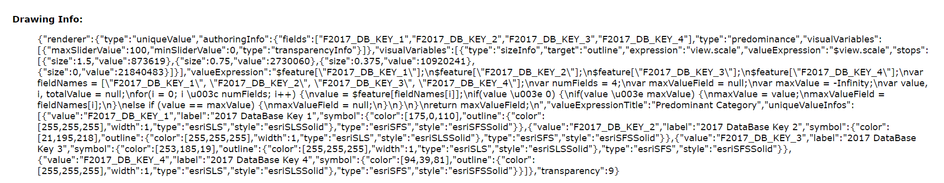

The drawing info parameter looks suspect too:
It appears that the substitution did not work and there are quite a few escape characters present:
    {\nvalue = $feature[fieldNames];\nif(value \u003e 0) {\nif(value \u003e maxValue) {\nmaxValue = value;\nmaxValueField = fieldNames;\n}\nelse if (value == maxValue) {\nmaxValueField = null;\n}\n}\n}\nreturn maxValueField;\n","valueExpressionTitle":"Predominant Category","uniqueValueInfos":[{"value":"F2017_DB_KEY_1","label":"2017 DataBase Key 1","symbol":{"color":[175,0,110],"outline":{"color":

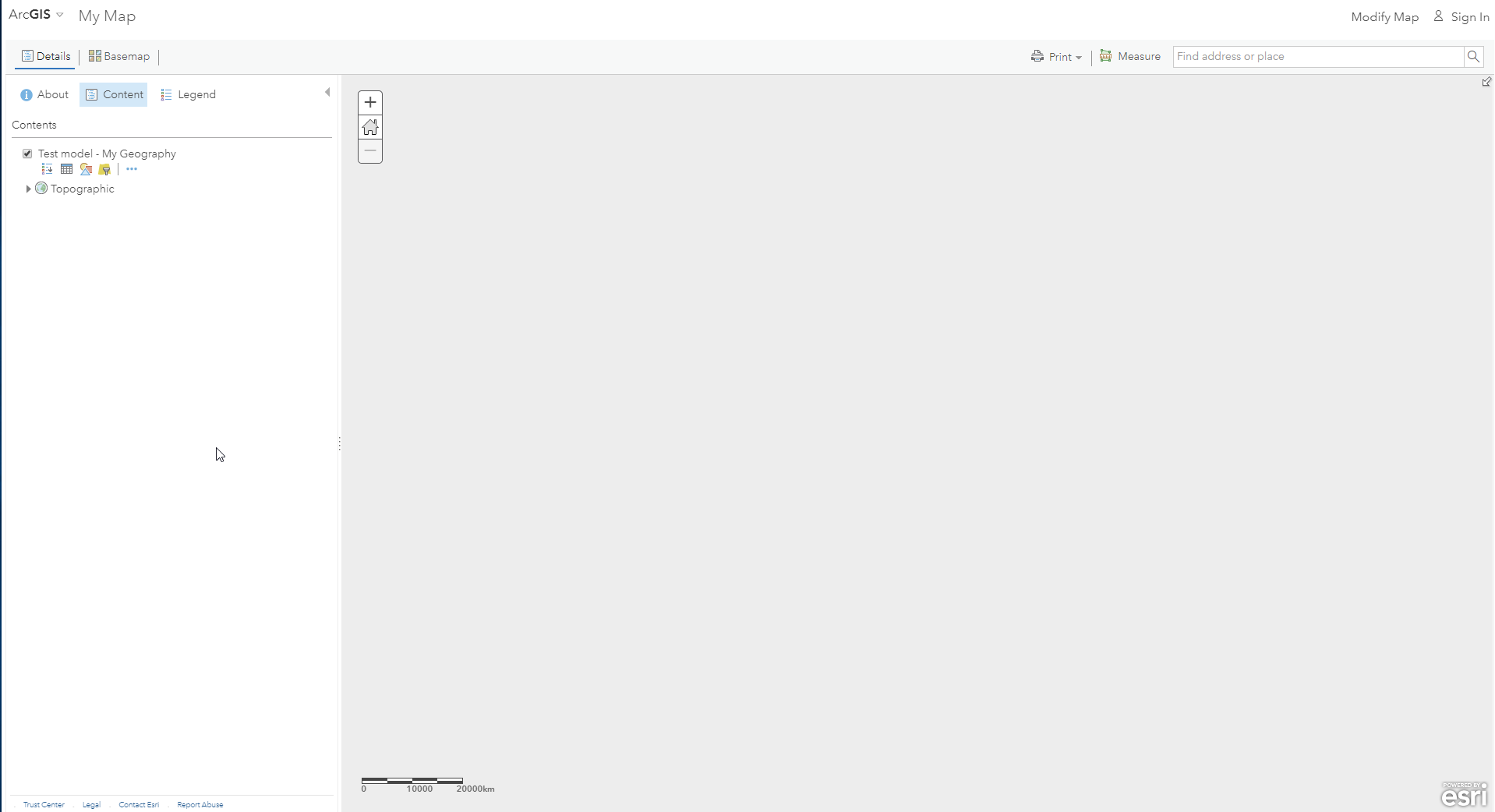

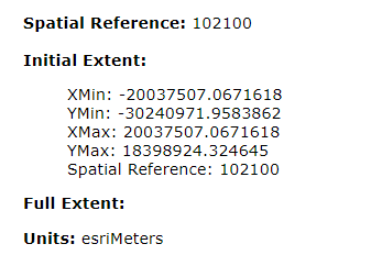

I tried adding your layer to a blank map on AGOL and then hit the zoom to. It broke the map; my pan and zoom stopped working. This leads me to think that the extent for the layer is incorrect?
Can you check if this is the extent specified is correct?
