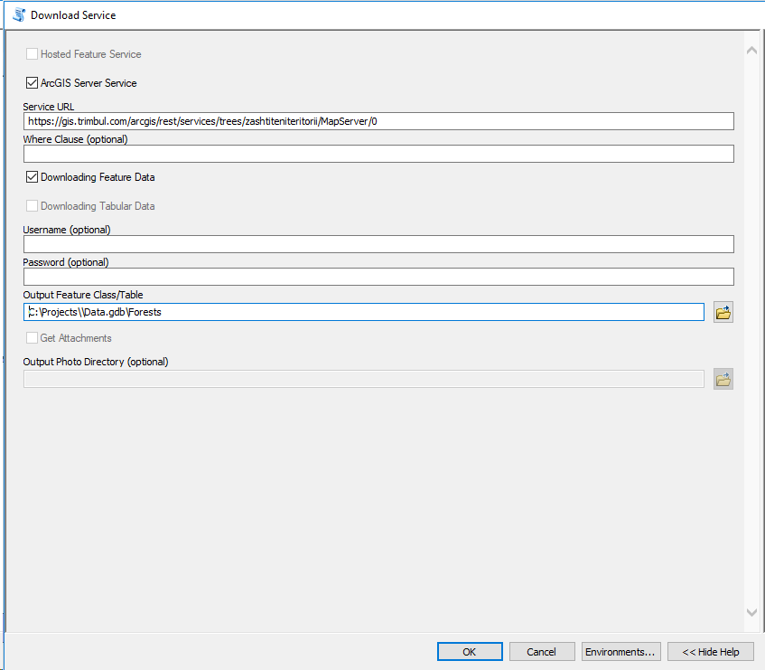

JakeSkinner
Esri Esteemed Contributor
Hi Stefan,
If you are using ArcGIS Desktop, you can use the following tool to download the data as a feature class:
Download ArcGIS Online Feature Service or ArcGIS Server Feature/Map Service
Ex:
EarlMedina
