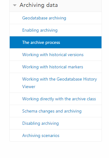

MichaelRobb
Honored Contributor
I think you are over complicating it all..  this is all managed by Catalog, ArcMap (History toolbar) and publishing with time layers... no issues.
Read:
The archive process—ArcGIS Help | ArcGIS Desktop
