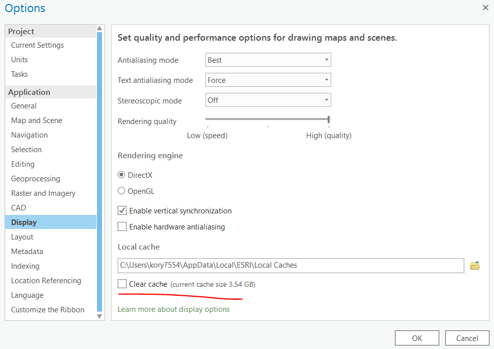

I agree with Dan on the display cache as something you should look at.
There are controls at the layer level:
As well as at the project level:
