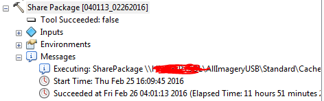

After using Share Package for months it is suddenly not happy.  Anyone ever have it do this where it says Succeeded and Failed in the same run?
It says complete but nothing shows up in AGO.
It is 52 GB but I have done larger before
thanks

I had a layer package not work for me. I went into the Control Panel to the Uninstall programs page. I did a "Repair" on ArcGIS and things worked properly again. It might be worth checking out.

Thanks but I have tried 3 different machines now all with the same result.  Going to try at home.

Do other packages work for you? What I'm asking is, is it just this one? And if so, can you find the original data and try re-packing it again?

Did you ever work it out?  We are having the exact same experience here with a 21GB tpk.

I am having the same problem as well.  It worked a week ago, but now I had to recreate it and it will not push it up or it stays at 0%.  Any solution?

Nope never did get it to work.  I have to take the tpk to my house every time i want to upload.  We are also still having some login issue with the Android SDK.
