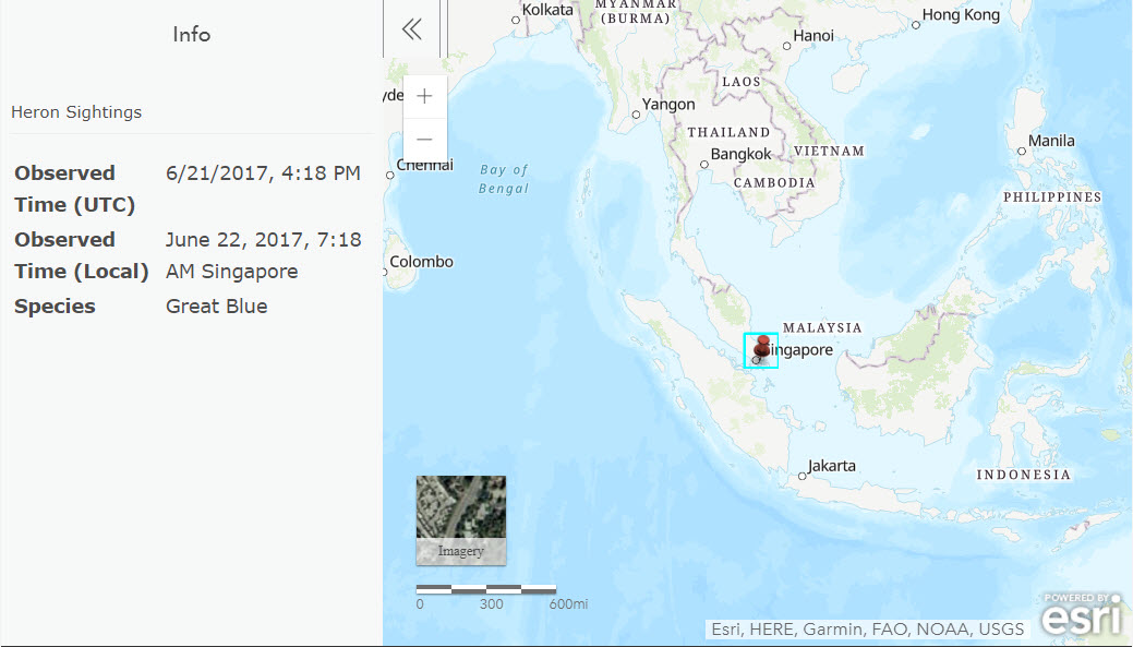

I'm going to use an existing example of my Heron Watch Data and display the description when one is present. I will hide the field value and field label when it isn't present. View the Heron location in Singapore to see a feature with no description, or add features using this GeoForm App with no description.

Description Values not Present
