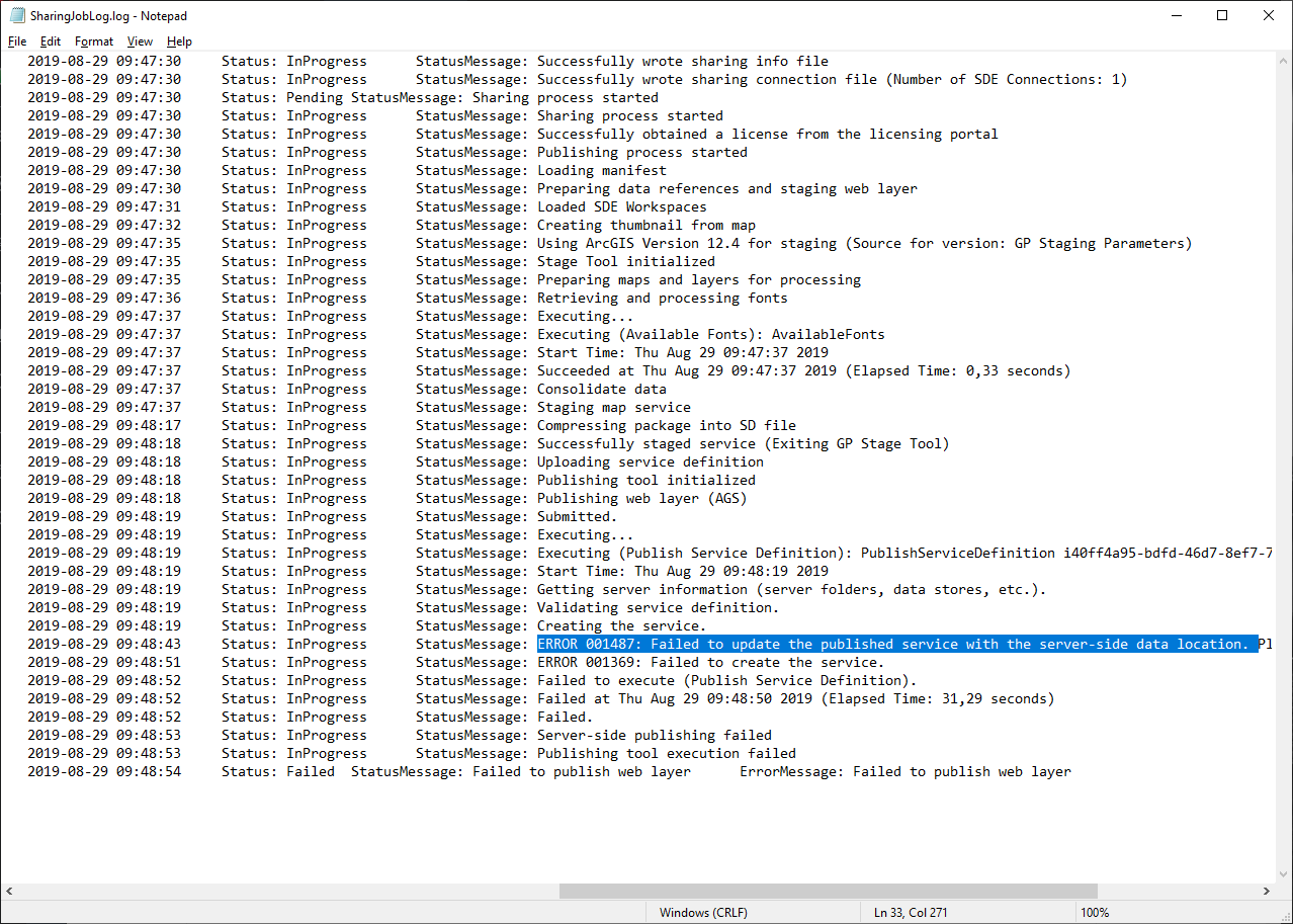

Everytime we try to update a map service using the overwrite web layer option in ArcGIS Pro  the error appears.
Notice that this error appears only when we try to do an "Overwrite" . The publish  new web layer tool always works fine.
We use Arcgis pro 2.4 to publish on ArcGIS Enterporise 10.7 istance (Porlal and Arcgis server 10.7 on windows server)
The complete Log is here attached:

When trying to publish from AGS from sd file I get:
 ERROR 001487: Failed to update the published service with the server-side data location. Please see the server's log for more details. ERROR 001369: Failed to create the service. Failed to execute (Publish Service Definition).
Nothing more in the server log for this attempt than this:
Failed to create the service.: Updating the server connection string for layer sqldbuatgisdb.PROPERTY.prLettingEasementLine failed. Attempted connection string was ENCRYPTED_PASSWORD=fffff;SERVER=ip.net;INSTANCE="DSID=c9e5a34b-8bec-4f9f-85e6-87daf7d98674";DBCLIENT=sqlserver;DB_CONNECTION_PROPERTIES=ip.net;DATABASE=db;USER=user;VERSION=sde.DEFAULT;AUTHENTICATION_MODE=DBMS. Table name is sqldbuatgisdb.user.fc. Please verify the data exists on the server.
