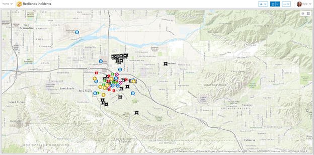

With the latest release of Operations Dashboard, you can create and use dashboards on the web without downloading an authoring app. In 5 steps, we’ll have a dashboard that combines a map and some elements to get information out to the public. This particular dashboard is going to show reports of incidents occurring around Redlands, CA. Your dashboard will look like this once you finish: Redlands Incidents dashboard.

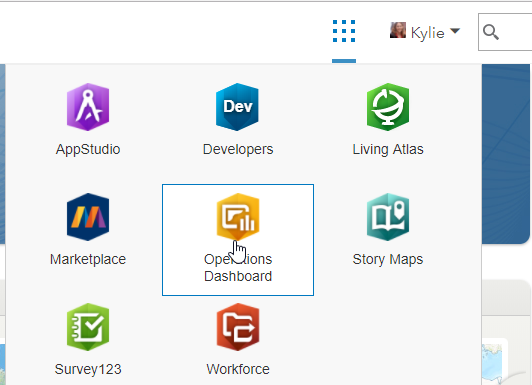

    Log in to your ArcGIS organization and use the app switcher to go to Operations Dashboard.

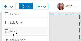

    We'll start with adding the map. Click Add, choose Map, and select the map you saved from my shared map. By default, the layers honor the refresh intervals from the map and are selectable.
    Add in some map tools, including Basemap and Layer Visibility, and click Done. The map is added to your dashboard.

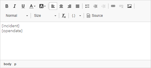

    Add a List and select the Reported Incidents - Dispatch layer. On the General tab, give it a title “Incidents” and on the List tab set the Line Item Text to have icon, type, and open date:

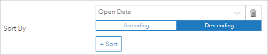

    On the Data tab, click Sort and sort descending on the Open Date.

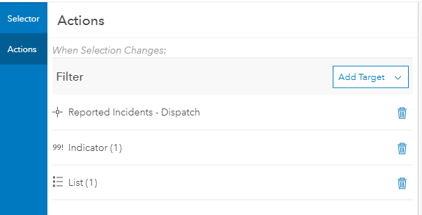

    In the Actions tab, add a When Selection Changes action that filters the Reported Incidents – Dispatch layer. Add additional actions so that the filter is also applied to the list and indicator.
