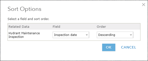

  3. The hydrant features are how we’ll access our inspections. We’ll use most of the defaults for the hydrant pop-up, but we do want to configure it so that the inspections show with newest inspections first. Make sure you are configuring the pop-up for the hydrants (features), not the inspections (in the table), and use the Sort Options button at the bottom of the Configure Pop-up pane.
