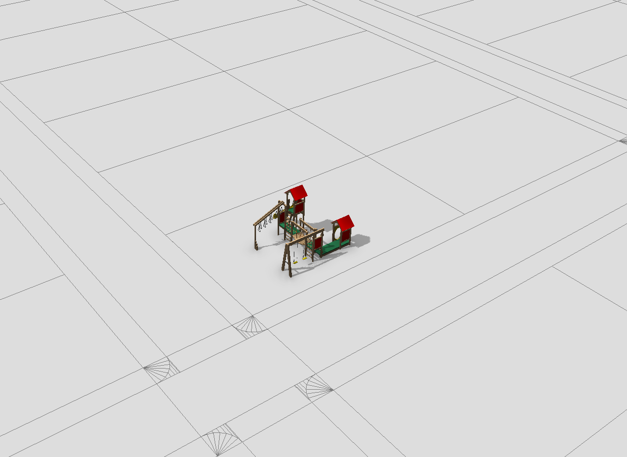

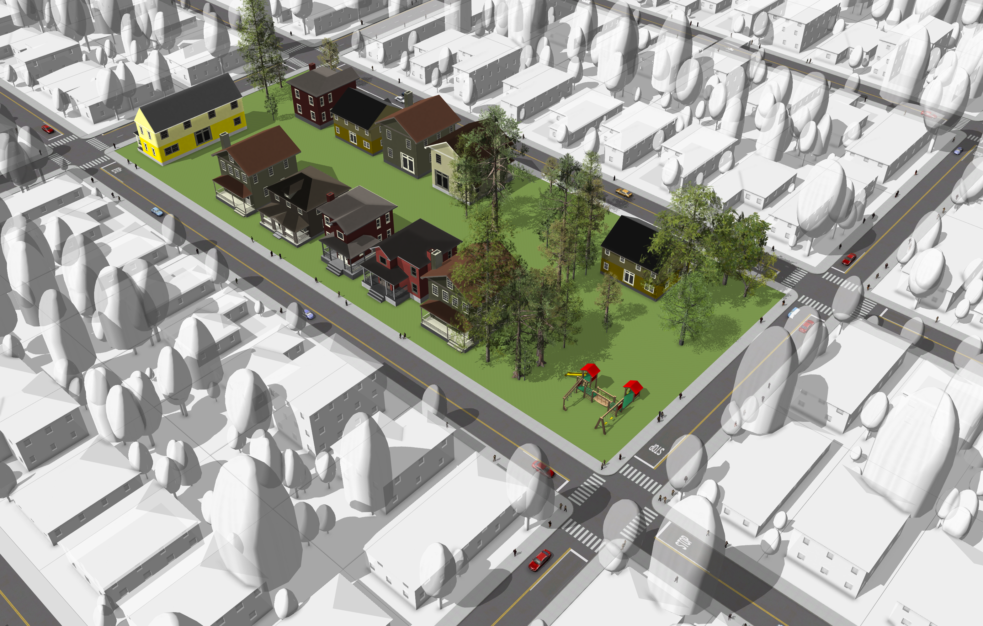

Do you mean something like the tot lot in my image?Park in Vacant Residential Lot.png
I started out using a rule that would place the model - something like this:
Playstructure-->
     i("Playstructure.dae")
But putting in the right spot and then the rotation and scale - just too painful. In this instance it was just plain easier to place the model. So in this scene - which supports a plan recommendation to consider using vacant lots at the end of blocks for tot lots - the model is just placed. I am however working on a some code that will develop a park site based on size and surrounding uses/population and I do plan on using CGA to build soccer fields and basketball courts (right angle type stuff), and just inserting assets like goals, play structures, backstops, etc... Hope this helps.
