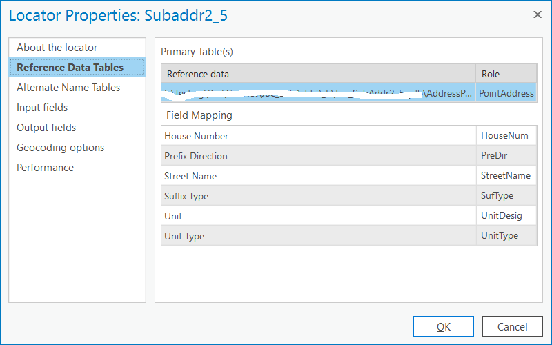

I mocked up some data based on your screenshot and cannot reproduce the behavior you described. I get match results for each unit whether I use # or Apt as the unit indicator. Below is the field mapping from the locator properties.
Do you get different results when you compare the locators with and without the JoinID mapped?
