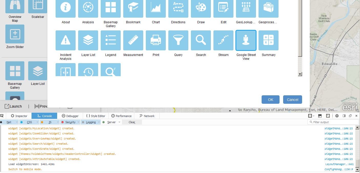

So even after you click OK to adding the StreetView widget there is still no errors in the console?
devarsimajumder2
no errors. thats the weird part.  i opeend the console up and  it didnt say anything at all.   I  may be missing something here.   The files are all saved in the right folder beacsue the widget does come up.  At this point i am not sure what i am doing wrong.   pretty confusing  due to the fact i am not understanding something.

I wanted to touch base with you. Is there any way that  this streetview can work on my existing apps or is it safe to say  if i want the streetview to work on them i will have to build them from scratch again? thanks Robert Scheitlin, GISP
RobertScheitlin__GISP
MVP Emeritus
Devarsi,
  I would say you need to re-build them as I don't know why the 1.2 version is not working for you.
