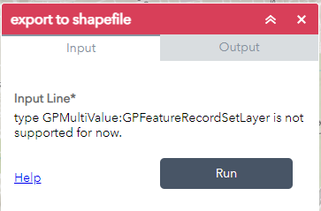

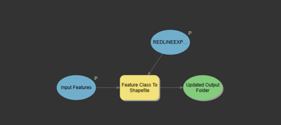

ahargreaves_FW
@JamesCrandall I am attempting to do what you say with a simple GP model that exports features to shapefiles. It works fine in Pro, and allows me to publish it as a service. However, when I use that service in the WAB GP tool my input and output parameters fail to show. How do I expose these?
