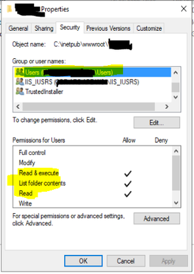

WilliamSpillane
We had the same issue with an internal installation and were getting the same error. We had the custom widget deployed in a folder below wwwroot/    The solution that we found was to access the widget folder using Windows Explorer, right-click on it and grant permissions to the <servername>\Users group and that also seemed to cure the problem. We're on v11.1
