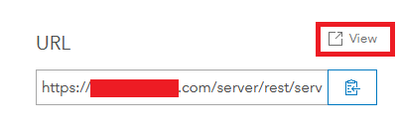

  2. The URL, at least in my case, needs to be updated from default for the Print widget to work. The URL it is looking for is the same as the REST Service URL for Export Web Map. Go to your portal > find/open the print tool > scroll down > look for URL at the bottom right and click View to go to the REST Service Directory.
    Once there, click the "Export Web Map" URL, and then copy the full URL from the URL bar and paste into your Print widget. If you have Service Directory disabled, this will obviously not work.
    1. If your Service Directory is disabled, you can always try this: In your Print widget, copy the URL (see image above for reference) and paste into your URL bar (or and text editor - this is just convenient). Then, add /Export Web Map (with spaces). See below for before and after
