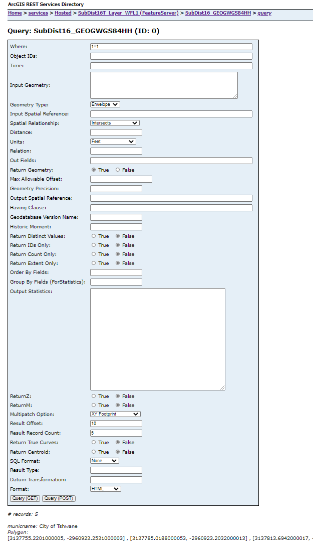

ArcGIS Online is basically just a newer version of the ArcGIS Enterprise system  so this is how it looks when you query a layer.
What you want to research is the Result Offset which basically means from 0 how may records to skip and Result Record Count which means how many records to return E.G if the offset is 10  start at record 10 and return 5 records.
Info:
Query (Map Service/Layer)—ArcGIS REST API | ArcGIS for Developers
Example:
https://some_server.esri-southafrica.com/server/rest/services/Hosted/SubDist16T_Layer_WFL1/FeatureSe...
Returns
"exceededTransferLimit": true,
"features": [{
"attributes": {
"municname": "City of Tshwane"
"geometry": {
"rings": [[...]]
"fields": [{
"name": "municname",
"type": "esriFieldTypeString",
"alias": "MUNICNAME",
"length": 100,
"defaultValue": "",
"modelName": "MUNICNAME"
"geometryType": "esriGeometryPolygon",
"spatialReference": {
"wkid": 102100,
"latestWkid": 3857
"objectIdFieldName": "objectid_12",
"hasZ": false,
"hasM": false
BillFox
