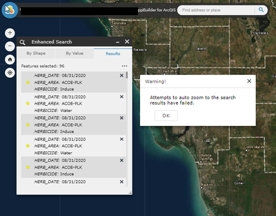

Hi again,
Strange issue with configuring eSearch on a hosted feature service.  The service has 3 layers but 1 of the layers is generating errors with the auto zoom to search results property set.  The search actually produces the correct result but is failing to auto zoom as well as zoom from clicking on a result.

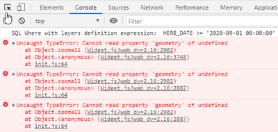

This is data problem, not an issue with this awesome widget -- specifically, a geometry problem as evidenced in the dev tools screenshot.  It's null/empty.
Upon inspection of the source data used to publish the service, it has some null coordinate values that are used to build the feature class, hence the null/empty shape column I suppose.
