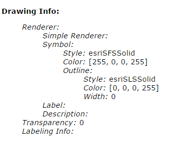

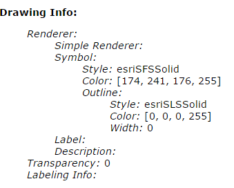

Two polygon layers are displayed in wab with the same color despite the fact that the layers were published in different colors.
I want to manually to change the color of the features for each layer but I cannot see where. Does config of the locallayer support the color tag?

LefterisKoumis
That's what I thought at first, but when I checked the web service for each layer that color is not the same.

LefterisKoumis
To try to change the color of the polygon, I removed it from the mxd file, republished the web service. Then, I placed it back to the mxd and republished it, and still the wab shows the same color!!!! The rest services shows the new color. It got to be something in wab that determines what color to show for a polygon regardless of what the rest services define.
Then, I tried  another way. I removed the layer from the layerlist and saved it. Then, brought it back and voila. The layer adapted the color as defined by the rest service. I guess the wab does not update unless a change is made on the layerlist.
