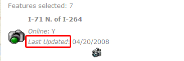

I think that is correct, for example I am searching an address to bring back the school they would attend based on that address, so the results that popup after searching would be:
School:  Washington Elementary
The label "School:" and the value it returns Washington Elementary are all the same color, and kind of blend together.  I was thinking of changing the Washington Elementary to a different color or bolding it or something to offset it from the label.

  OK, since the Italics is not enough difference for you then you can just ass a line of code to the List.js and some css to the style.css for this:
css:
.search-list-item .attTitle {
  color:blue;
List.js (add line 10):
        if(item.rsltcontent !== ""){
          var attArr = item.rsltcontent.split('<br>');
          var attValArr;
          var label;
          var attTitle;
          var arrayLength = attArr.length;
          for (var i = 0; i < arrayLength; i++) {
            attValArr = attArr.split('</em>: ');
            attTitle = domConstruct.create("em");
            domClass.add(attTitle, "attTitle");

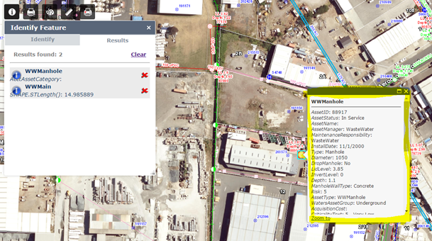

That is very helpful Robert.
The tweak formats the attributes in the widget's result area.
is it possible to replicate similar modification to the results in the pop-up window as well?
Amit
AmitKokje2
Deactivated User
Hi Robert,
Based on your response to Steve Adams, I managed to configure attributes in  the results window.
If there is only one attribute to display as in this case, Tweaking of list.js works very well.
However if there are number of fields to display as resultant attributes, by default the configuration picks up last field / attribute (for example shape.length / area in most of the cases).
Is there way to configure the display attribute to a specific field?  (Asset ID or Asset name for example).
Thus the result list will only display selected feature with one Attribute while popup will display full attributes, avoiding unnecessary duplications attributes.

Amit,
   I am not sure I understand. The code provided work for more than one attribute.
There is a popup only setting for each field you configure.
