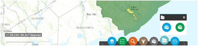

I would like to change the icon of the widget group: need to change the folder icon to the query icon.
But the Develop Edition does not provide any options for that. Can I change it from the source code somewhere? Thanks a lot!

Jake,
  Sure just change or edit the group_icon.png:
[install dir]\server\apps\[app #]\themes\LaunchpadTheme\widgets\AnchorBarController\images\group_icon.png
