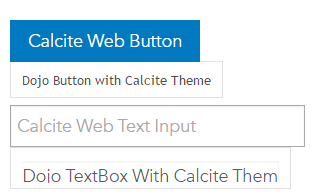

Is the Calcite theme (included as Beta with Esri JS API 3.16) somehow related with the Calcite Web CSS framework (Calcite Web | Esri Design Patterns)?
The Calcite theme defines modern look and feel for Dojo dijits and a subset of Esri dijits. It can be used to create a new WAB theme with unified design for Dojo dijits and Esri dijits (as you did in demo 2 and 3). However, I do not want to create the UI of my own widgets using Dojo dijits (it has significant DOM footprint and complexity), but I need to style my own widgets the same as the rest of the WAB. So, I was thinking to use Calcite Web CSS framework to design my own widgets, however, the individual components (buttons, inputs, ...) looks differently then their Dojo counterparts themed with Esri JS API Calcite theme.

It is true that the UI components across different Calcite libraries look different. The idea is that these three libraries/frameworks (Web, Bootstrap, and Dojo) only share the same color swatch, font family, and that is pretty much it. I had the same question before I started building the Calcite Dojo theme, and the answer is we expect developers only pick one library to work with. But this is not the case for WAB, since people can develop widgets with whatever UI framework they pick. So in this case, they need to customize their own CSS to make them look consistent.
I am going to build a CSS SASS framework for WAB that will cover all UI elements, and I think that might make your widget or theme development easier.
And for Semantic Dojo, no, I have not used it. The potential issue is that other importing another Dojo theme will only update the Dojo dijits, not ArcGIS API's dijits. So UI components in WAB will still look inconsistent. It still requires a lot effort to be able to cover all UI components.
