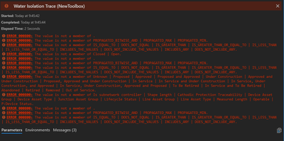

Hello,
I deployed Water Distribution Data Management for ArcGIS Enterprise for testing to ArcGIS Pro 2.8. and has started testing on sample data.

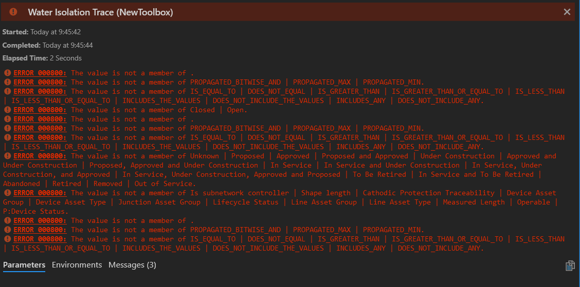

I am getting errors for Tracing - in Water isolation trace tool.
At first the tool failed to load (invalid tool error), but this was fixed by re-validating the mode in Model Builder, but regardless this the tool has returned error - see attached screen.

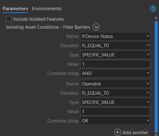

when the default attributes have been entered:
Is there any problem with PRO 2.8? Or is there any simple fix?
Thank you,
Vladimir

Hi Vladimir,
This was found and fixed for the upcoming release.
To resolve the issue, edit the model in ModelBuilder, add a new Utility Network Trace and move all connections to the new trace then delete the old trace. Save the model and try again.

VHolubec
Hi @JoelSmith3 ,
thank you so much! It works great now.
