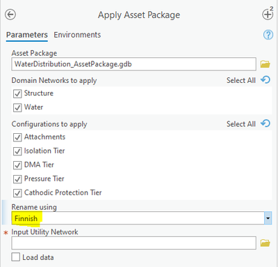

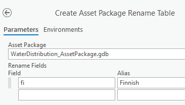

It is possible to use the Modification Tables to add Finnish Aliases to the components of the Water Distribution Network Foundation solution. Use the steps here: to add a D_Rename table.
After the field has been added, translate the values in the "Current Name" field into the Finnish field for each row in the table.
When you are ready to apply your asset package you will see the option to select Finnish in the "Rename using".
I hope this helps!
