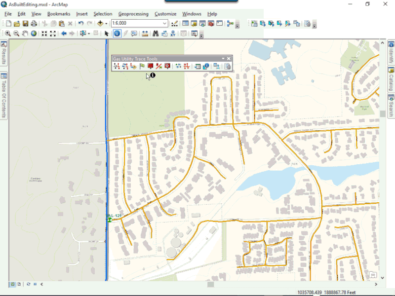

On March 1st, we are releasing an update to the Water Utility Network Editing solution and a preview of the analysis tools for the Gas As-Built Editing solution.  This update will provide a connection isolation trace tool for gas customer and an update the water valve isolation trace for water customers.  These trace routines have a new option on how the results are returned.  Instead of a selection set or a graphic, you can now get a copy of the results as a set of in-memory layers.  This new return option allowed us to craft a model to easily share these to a service so anyone in the organization can access the results.  Check out the video below highlighting these new features.output_4UTUOV.gif
