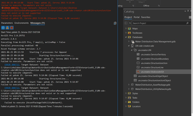

I am trying to load sample data of WaterDistributionDataManagementForArcGISEnterprise v 1.1 to SDE geodatabase (PostgrSQL).
The Tool Apply Asset Package has failed on error: StructureLine does not exist or is not supported (error 000732) when executing Append operation. But this particular Feature class is present in the dataset.
Is there any fix for this issue?

I am using PRO 2.8.0 with dltsolutions 2.7.1 and untools 2.8.1. Every attempt goes to the fresh empty SDE geodatabase, so there shouldn´t be any collision. But also it´s true that now I  got different errors, when recording my workflow and that I´ve often seen some error in Utility Data Management Support.pyt.
See the attached video.
On Pro 2.8.1 on another machine is the situation worse. So my only question is - is PRO 2.8 supported here? Because for now I don´t see any other reason why this shouldn´t work.

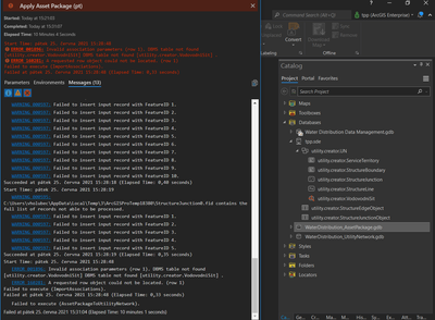

Now I am stuck on last step with errors - 001896 and 160281. See the messages below.
I will dig deeper on the database server.
I also checked the geometry type and there is ST_Geometry used, as expected.

Summarizing the errors below. Interesting that in the log there is no Append error, but the error is on Import Associations.
WARNING 000595: C:\Users\vholubec\AppData\Local\Temp\3\ArcGISProTemp18380\WaterDevice0.fid contains the full list of records not able to be processed.WARNING 000595: C:\Users\vholubec\AppData\Local\Temp\3\ArcGISProTemp18380\WaterLine0.fid WARNING 000595: C:\Users\vholubec\AppData\Local\Temp\3\ArcGISProTemp18380\WaterJunction0.fid contains the full list of records not able to be processed.WARNING 000595: C:\Users\vholubec\AppData\Local\Temp\3\ArcGISProTemp18380\StructureBoundary0.fid contains the full list of records not able to be processed.WARNING 000595: C:\Users\vholubec\AppData\Local\Temp\3\ArcGISProTemp18380\WaterAssembly0.fid contains the full list of records not able to be processed.WARNING 000595: C:\Users\vholubec\AppData\Local\Temp\3\ArcGISProTemp18380\StructureJunction0.fid contains the full list of records not able to be processed.
ERROR 001896: Invalid association parameters (row 1). DBMS table not found [utility.creator.VodovodniSit] DBMS table not found [utility.creator.VodovodniSit] .ERROR 160281: A requested row object could not be located. (row 1) Failed to execute (ImportAssociations).

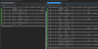

Anyway I´ve tried to appned data from asset package to SDE and I get the schema mismatch error:
ERROR 000466: C:\Users\vholubec\Desktop\WaterDistributionDataManagementForArcGISEnterpriseV1_1\Databases\WaterDistribution_AssetPackage.gdb\UtilityNetwork\StructureJunction
does not match the schema of target
C:\Users\vholubec\Desktop\WaterDistributionDataManagementForArcGISEnterpriseV1_1\tpp.sde\utility.creator.UN\utility.creator.StructureJunction
I assume the previous step with Asset Package to File Geodatabase shouldn´t affect the Asset Pacakge.
But the schema is really different - don´t know why:
Did I miss some step?

That's not good. That means all the calls to add fields failed for some reason.
Apply Asset Package and Asset Package to File Geodatabase are both read operations on the source data, so nothing there.
At this point you might need to reach out to support. We load this specific asset package frequently into PostgreSQL without issue.
