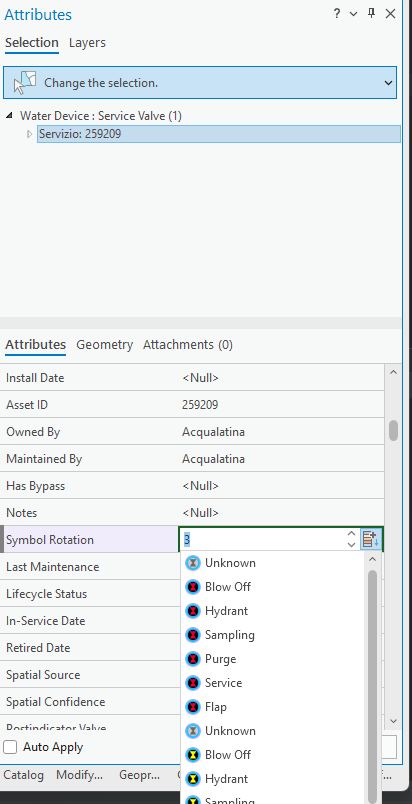

I Made a water distribution utility network using esri solution. I didn't modify original utlity network fields and domains. I have only added some subtypes to water device feature class.
I have added new fields with associated new domains.
I have a problem in every Water Device sub layer, in the Attributes panel:  symbol rotation show wrong description (view Figure).
I have a problem also with field calculate on symbol rotation field using arcpy: 'arcgisscripting.ExecuteError: ERROR 160912: Failed to evaluate Arcade expression.
Failed to execute (CalculateField)'.
Has something similar happened to others? Do you have any ideas to help me?
Many thanks in advance.
Sabina
CarlVon_Stetten1
Sabina,
It looks like a coded value domain got configured on the SymbolRotation attribute.  SymbolRotation should receive a range domain allowing only whole numbers between 0 and 359.
-Carl
RobertKrisher
That looks like a bug, we'll take a look at it. If you end up logging a case let us know.
