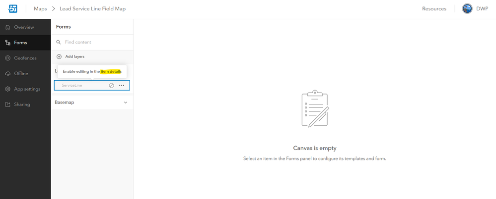

ChrisMiller_AK
Worked perfectly until Step 7- It's not letting me edit. Says to allow editing to item. Double checked the ServiceLine_editing feature service view and editing is enabled.

AlexKabak
Hi Chris,
Please ensure the ServiceLine_editing feature service view is in the Lead Service Line Field Map map and not the ServiceLine feature service. Looking at your attached image the layer is "ServiceLine" and is not editable, which means it could be the ServiceLine feature service (which you are correct is set to not be editable). The out-of-box solution is packaged with the Lead Service Line Field Map using the ServiceLine_editing view (renamed in the map "Service Line" with a space between service and line).
ChrisMiller_AK
Hmm...I tried my best not to alter the layers from the default layers, but it does appear that the layers got swamped out. I think I know when it happened. While teaching myself, I added the ServiceLine feature layer to the Lead Service Line Field Map in Field Maps Designer. Both layers are added with the same name, Service Line, to Field Maps Designer and apparently, I deleted the wrong one. 🙁
I don't typically save when snooping around but it appears I did this time. Lesson learned. The layer and associated smart form have a lot of expressions and auto calculations that were lost when removing...bummer.
Since we haven't done much more than add fields, I think I'm just going to redeploy a new solution, rather than try to recreate the layer and smart form.  Thanks for the assistance.
