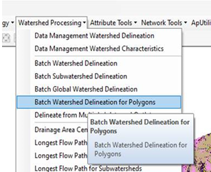

Hi,
In ArcHydro in Arcmap, I have the tool “Batch Watershed Delineation for Polygons”, which I have used a lot. I have installed ArcHydro for ArcGIS PRO, but I can’t find this tool when using ArcGIS PRO.
Is the “Batch Watershed Delineation for Polygons” tool included in ArcHydro for ArcGIS PRO, or will it be included in the near future?
This is a tool that is very useful in my work, so I would be superhappy if I can use it in PRO.

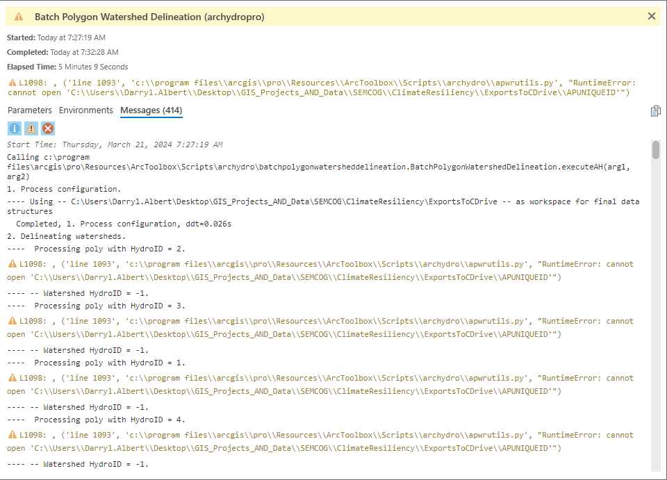

Not sure if there is a thread for this elsewhere, but I can't seem to get the Batch Polygon Watershed Delineation tool to work in Pro 3.0 or greater.  I just installed 3.2.2 and newest version of ArcHydro, but getting error 000732.  Seems to be looking for the apuniqueid table in the wrong place.  I've received this same error on 2 different machines with the same data.  Different versions of ArcGIS Pro and ArcHydro too.
Currently trying on Pro 3.2.2 and ArcHydro 3.1.59.

DarrylAlbert
Thanks Dean, I appreciate the response and software update.  I did install the newest version of the software, I was able to generate the watersheds for my polygons.  They did not provide the relating Hydro ID, I am still getting the error message that the apuniqueid cannot be opened.  Was this supposed to be resolved in the latest version?
DeanDjokic
are you using a feature class or a shape file as input into the tool (polygons)?  you should be using a feature class and the HydroID associated with that feature class should be "drawn" from the gdb holding the feature class.  so if you have external data you want to use as input (e.g. a shape file or a FC from a different gdb than your project gdb), first import them into your project gdb/FD, reassign HydroID if necessary, and then run the tool.
DarrylAlbert
Thanks Dean.  I reviewed the best practices document again and coupled with your suggestion, that did the trick.  Thank you!
