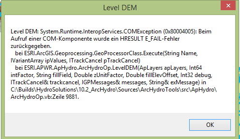

I´m running Arcmap 10.2.2 and installed Arc Hydro 10.2 x64  from this link
yellow.esri.com - /archydro/archydro/Setup/10.2.x/10.2.0.76/  .
The installation was successesfull.
Then I tried the Tutorial from this link yellow.esri.com - /archydro/archydro/Tutorial/  therefor I activated the Spatial Analyst.
Testing the first step of the Terrain Preprocessing I got the error.error.PNG
I hope someone can help me.

Not sure if the installers prevent this--they should--so it is possible you have the wrong mix of 64-bit'ness. If you installed the 64-bit ArcHydro extension, had you first installed the 64-bit geoprocessing for ArcGIS for Desktop as well?  The 64-bit geoprocessing extension installs another build of Python (64-bit), and remaps some of the Python calls to 64-bit ArcPy versions.  Those have to be there for the 64-bit ArcHydro tools to make use of.
Also, could be an issue with the Tutorial 2.0 exercise data (FGDB and/or Shape files). Truthfully it has been a while since I worked through them?   Christine Dartiguenave‌, any comment on changes needed to handle the old tutorial data in newer builds of ArcGIS and ArcHydro Tools?

I haven´t installed the 64-bit geoprocessing, so I uninstalled 64-bit Archydro.
Then I reinstlled Arcgis and Archydro (not 64-bit) but the Problem is still the same.
I regocnized that not all tools lead to this error. For example the "Flow Direction" and the "Flow Accumulation" are working.
Don´t know if it makes a difference.

I have exactly the same error. I have ArcGIS 10.2.2 and installed ArcHydro 10.2 (64-Bit). Do you have found any solutions yet, Verena Beckmann‌?
