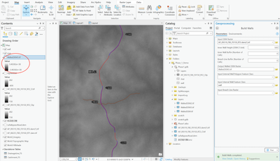

An error occurs when running the Build Walls tool.
885
08-06-2024 02:04 PM
TaoChenalan
When running the Build Walls tool, the generated wallDEM.tif raster is incorrect, and the elevation range becomes infinite and infinitesimal.

I've had this happen. Check the your projection/coordinate system is the same for all layers.
I put the agreestream and innerwall layers in a geodatabase and that seems to "help" (I've used ArcMap Desktop, so maybe ArcPro is different).
A side note:  I see you have 0 for your wall and breach buffers.
When I use walls and breaches I always use at least a 2 cell buffer for the walls. I only need one cell for the breachbuffer. The image below shows that with only 1 cell for the wall buffer, you can get "leaks" (orange line) since the flow direction grid will "see through" the wall where the non-walled cells meet at the corners (diagonals).

hello, Mark.It works, thank you. It seems we need to define the coordinate system before drawing the "wall"
