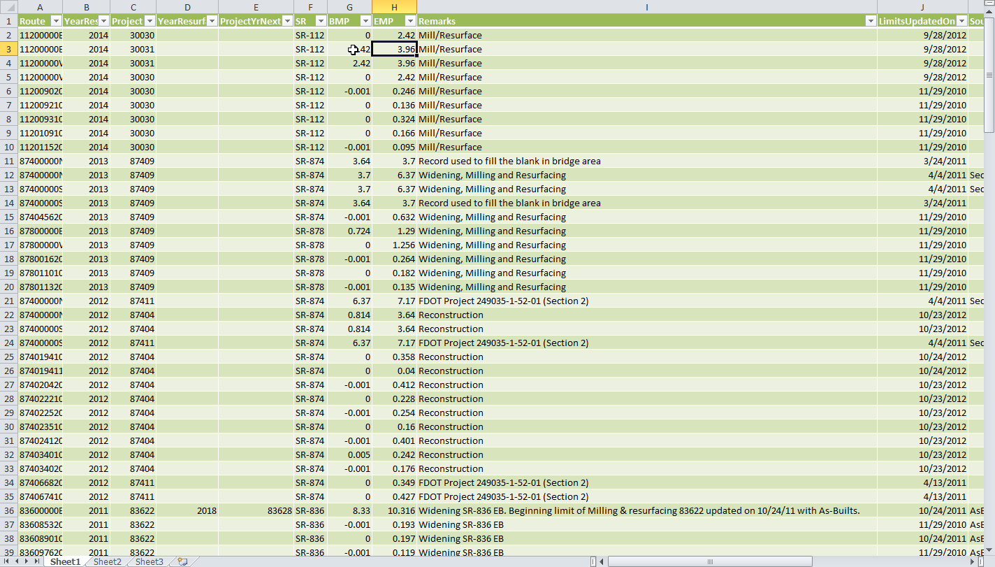

I believe that is true only if you purchase Roads and Highways to have linear referencing online.  To answer Ragnhild Tveit , I handle pavement Inspection and resurfacing in house and collect the attributes by linear referencing.  The outside collectors and editors edit excel spreadsheets with the data I wish collect along with the route and begin milepost(BMP) and end milepost(EMP).  This data can be "Event Mapped" to the Linear Referenced Route and be managed as a Data table within your Database.
Here is a sample spreadsheet created from a Data Table in which I store the attributes...  All these cross multiple segments.
