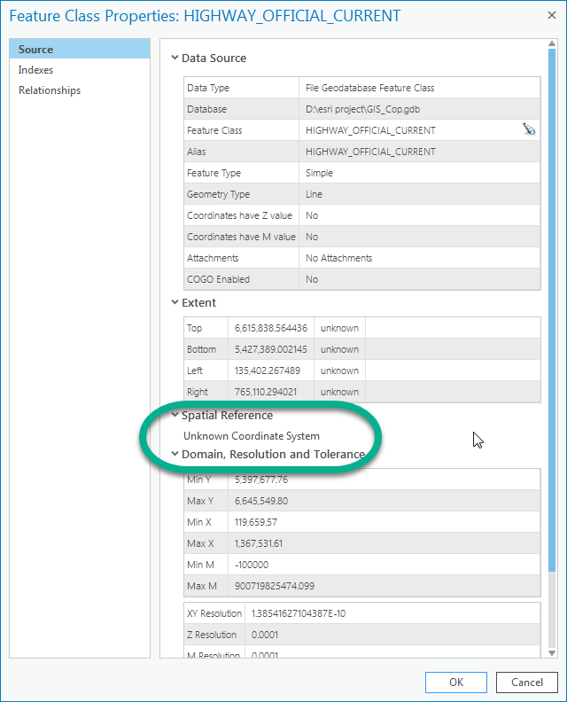

As I've only started a few months ago, I'm purely in ArcGIS Pro 2.3.0. I have data from my GIS group stored in Oracle > GeoMedia server structure with our UTM "Extended" zone 13N spatial. when I add this data to a new map it doesn't recognize the Spatial Reference.
I'm making a copy of the data to my local GISCopy.gdb, and was wondering if I can convert the GPS set esri to remember my database settings on each new map?

Thank you, this tool seems to work, however it seems to let me define features in my map, but not set the database itself. Do I need to convert my data and then export it to a .gdb?
Something like this:
1. Import data
2. "Define projection"
3. Export to my .gdb
Let me know if I picked the correct CRS; here are the settings from my .csf file
      At the bottom I included the "NAD 1983 UTM Zone 13N" I selected "WKID 26913"

After fighting with this for a couple months I found out our GIS groups oracle database uses Spatial format from before version 8.1.6. They have null value for the zone in SDO_GEOMETRY. I was able in FME tell it what zone I wanted and exported it into a GeoDatabase successfully.
