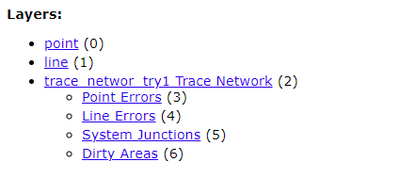

Now, I am trying to add trace configuration. When I add the same shared feature layer back in Arcgis Pro, it says that there is no network trace available. However, I can see in rest services that trace network services is also available.

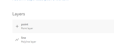

Features available in portal
Features what is visible in rest services.
My Questions:
  • How can I share trace network in arcgis enterprise as feature layer?
  • Why is the trace network visible in rest services but not in feature layer?
  • How can load the trace network back in arcGIS Pro once I have shared the network in arcgis enterprise?
