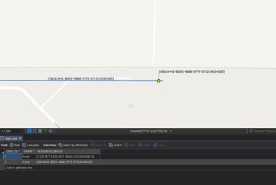

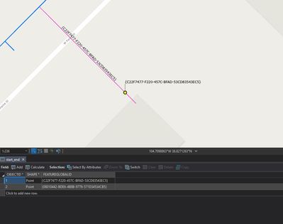

  • I created a feature class and populated the a FEATUREGLOBALID field with the GLOBALID of the source network feature. These points were snapped along the edge of the source network feature and still will not successfully trace, prompting error "001785 - No valid starting locations."  See screen shots below of my start points and source network features, labeled with GLOBALID, and the attribute table of my starting points feature class.
Starting point 1Starting point 1Starting point 2Starting point 2
