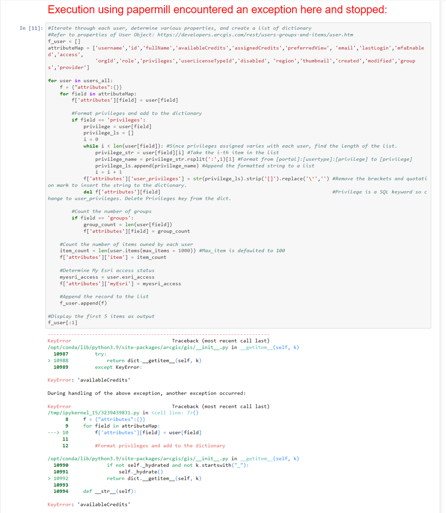

I have been trying to implement this admin dashboard solution but I keep running into an issue with the automated Notebook script failing every time it runs.  It keeps giving me the attached error message.  I am not a python programmer so i am at a lost as to how to fix this.  Do you or anybody else have any experience with this error?
Josh

Hello Josh,
Thanks for your message.

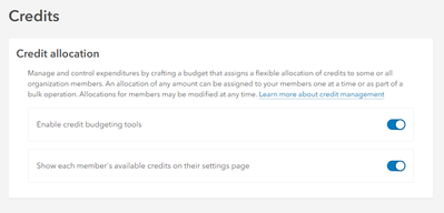

Is credit budgeting not turned on for the organization?
JoshHabel
Patrick,
I checked and it was not set up.  Now that it is set up the script ran successfully this morning so it looks like its good to go now!
