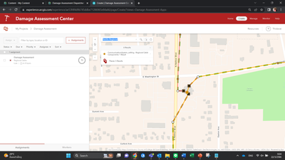

The solution also leverages two mobile applications, the Workforce Mobile app and Field Maps, to respond to damage assessment work orders, as well as collect those damages in the field. So now let's jump into the damage assessment center and start to showcase this solution. So we'll notice at the top there are a few tabs here that provide us with access to different applications as part of this overall solution. The first tab is the Create tab, which opens up Workforce for our GIS directly in the application. Here we can see the previous damage assessment work orders that have been assigned to our teams, and in our map, we have access to all of our asset information with the ability to search for a particular asset.
So in this example, we're searching for our asset number 925, which is a slice enclosure that we want to create a work order for someone to go out and take a look at. So creating an assignment allows us to select this as a damage assessment work order and assignment to one of our field technicians, Tyler West, and then populate some additional information on this work order. Now, as soon as we create this assignment, it'll be available for our technician to see in the field. Now, before we jump into the field, I want to open up the Manage tab, which allows us to see all of the work orders and damages that have been reported in the field.

ThidaratInthanawaranon
I've deployed this solution and tried to create an assignment by searching for the asset ID. But all the results of the search are map locations only. There is no result of an asset. Do I need to configure anything first?
SpatialNinja
Have you configured the Dispatcher web map to search using layers in the map? It can be configured via the Settings tab.
Solutions Engineer | Spatial Ninja  | GIS ️ | Telecommunications
Just configured them. it works well.
