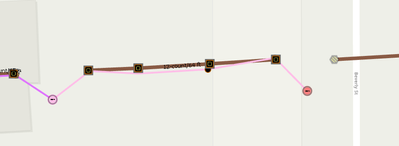

We are implementing UN Telco in Airport context (outdoor and indoor network) and we are testing some functionalities in Chicago Dataset. We have noticed that when we draw a new cable passing into an existing 3D structure, intermediate vertices have z = 0, also when the vertex is near an handhole with z assigned.
This is a 2D view
and this is a 3D view (in section) of the same cable... with verteces at z = 0

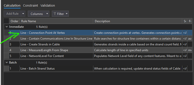

There's a way to use the z of structures? Maybe modifiing the Attribute Rule "Line - Connection Point At Vertex"?

Since two cables cannot exist in the same x,y,z, the Attribute Rule you pointed out is designed to set the Z of the cable to ensure there is no topological conflict.  However, in our case this may not be the behavior you desire.  If so, you can remove/dispable/delete the attribute rule.  However, you will need to ensure the cables are not all occupying the same x,y,z.

You write: "the Attribute Rule you pointed out is designed to set the Z of the cable", but my problem it's exactly that the Z of the cable is not set, also if it's created a connection Point.
Also: cable is near structure for containment associations, but is not coincident with structure.

It is difficult to know just looking at the picture, but if we assume there is only one cable, then the attribute rule we provided will not change the Z value of the cable.  The attribute rule is not designed to set the Z's of cables based on a Structure Junction's Z value. It may be easier for us to communicate directly.  My contact email address is jalsup@esri.com
