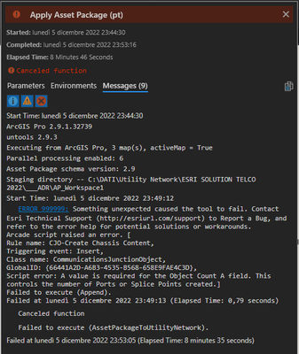

I've modified my script for append between Asset Packages.
But when I run "Apply Asset package" (on an Empty FGDB created with "Asset Package to Geodatabase" tool) I received this error:

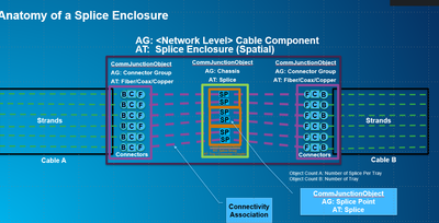

I've ever seen Object Count A and Object Count B empty, for example after a creation of a patch panel.
And also in Chicago data.

You are running Apply Asset Package on an existing comms asset package?  That means the attribute rules for editing are enabled.  They are rejecting loading the features.  Since you loaded data into the new asset package, run Asset Package to Geodatabase to create a new UN.

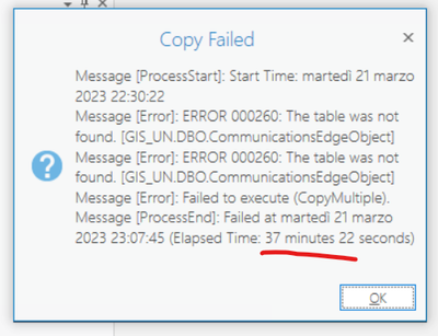

Hello everyone,
I am having difficulty transferring the UN contents from an Enterprise GDB to our own SQL Server.

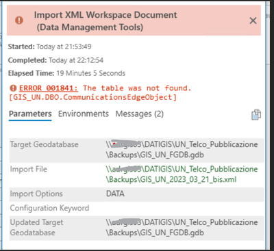

The Dataser copy and paste special into a new empty FGDB ends with this error

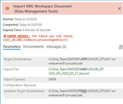

Import of an XML Document into FGDB makes this error,
and also into a SQL Server GDB

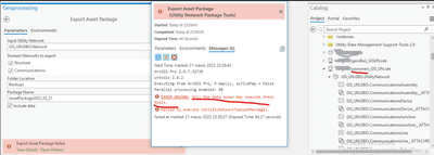

I'tried to Export Asset Package but...
"unoner" is a db user with sysadmin role...
Where I'm wrong?
