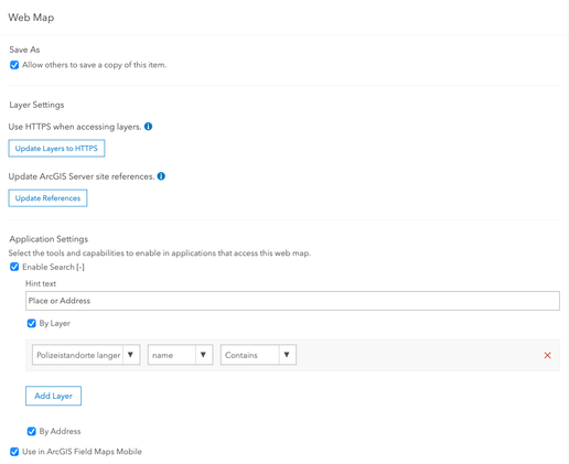

Hello everybody,
is it possible in ArcGIS Swift SDK to search only in the layer feature attributes that are configured as searchable in ArcGIS Enterprise (image below) and ignore the other attributes in a featureTable? We know its working with the searchbar in MapViewer in ArcGIS Enterprise and we would like to adapt the same functionality in iOS App.
When we are using "queryFeatures" function with "QueryParameters" the results of all layer feature attributes which match a specific input are returned regardless of weather configured searchable or not.
Are there any functions / parameters we should know about that?
Thank you very much.
Marvin

Our goal is to configure the searchable featureLayers and attributes in ArcGIS Enterprise in Application Settings and use it in our iOS App. So layerFeature attributes in a table which are not configured "searchable" should not be searched. Currently we do something similar as you showed in your last post but it did not work because Application Settings search-configuration is not related to the queries directly.
Based on your information I think this functionality is not directly supported through the ArcGIS Swift SDK right? As you proposed, I tried to get the applicationSettings(search) information from the "unsupportedJson" property. But there is a warning that you should not use it in public and it will be removed in the future.
Instead I tried to use toJson() on the specific map-object to get the applicationSettings. And in this json I can see the layers which are configured as searchable with their layerAttributes and type of search. Do you think that its a valid approach to use this json to build up our SQL clauses?
