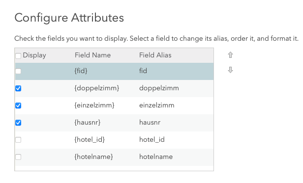

I can give you an example for the expected popup: In the "Pop-Up Content" section in ArcGIS Enterprise we have selected three fields to show up in the popup. Our expectation would be to just see this three fields in a popup in the iOS-App. In the portal's mapviewer its working fine, so we just see the configured fields. But in our iOS-App if we now e.g. select a feature of the specific layer on the map, then we still see all fields of this layer although we configured it in the portal. So the fields configuration seem to be ignored with the Swift-SDK. Hope it helps.

@mmoosbac94 What version of ArcGIS Enterprise are you using?
To help us reproduce the issue, can you provide a json or a screenshot of the popup definition you have configured in the webmap?
mmoosbac94
Hi @DiveshGoyal We are using ArcGIS Enterprise version 10.91.
Bildschirmfoto 2024-09-23 um 09.37.17.pngBildschirmfoto 2024-09-23 um 09.37.33.png
