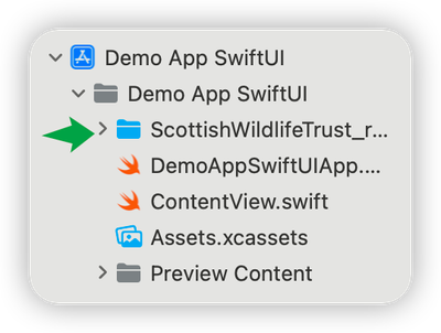

Your code logic is correct (despite some minor UI and styling issues) and I'm able to load a shapefile from the bundle with it.
The problem might be how you added the files to the bundle. If you are reading the files from the Documents folder, or using FileImporter, there shouldn't be this problem.
When adding files to an app bundle, please note the difference between Create groups vs Create folder reference, where groups has the gray folder icon in the project navigator, while a folder reference has the blue folder icon.
The key difference between these two is that group is an logical hierarchy, where all the files are stored at the same top level folder of the app bundle, and only grouped logically by the Xcode project file. Whereas a folder reference retains the actually folder structure in the app bundle of the added files.
Because shapefile format is not a single file - it contains various metadata and supporting files, the folder structure needs to be retained. When you add the folder of the shapefile to the project, use the Create folder references radio button.
Please see the code project attached for an idea. Let me know if you have more questions 🙂
