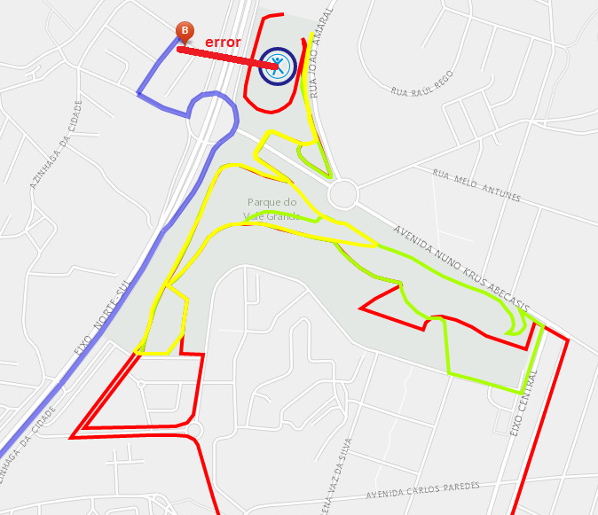

I'm using this template to find sports facilities in Lisbon. When I use the routing functionality sometimes the end point is too far from the facility as you can see in this picture:

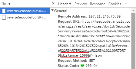

Using DevTools in Chrome I found out the problem in a reverseGeocode call:

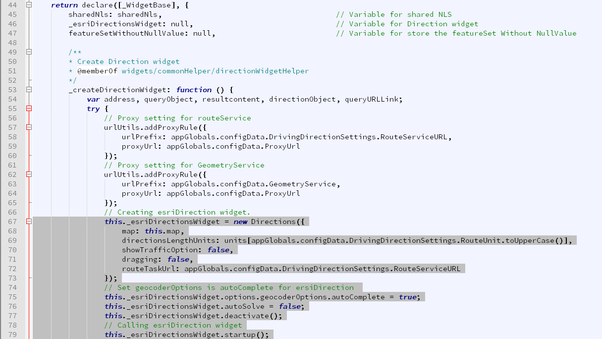

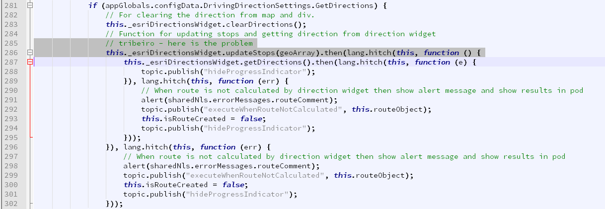

Now I need to know the exact line where this is called. I searched...searched...and found it:
.../js/library/widgets/commonHelper/directionWidgetHelper.js
OK. Now what is the _esriDirectionsWidget?

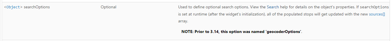

At this point the "only" thing I need is to find how to change distance parameter. I searched a little bit in the JavaScript API and I found out this:
Directions | API Reference | ArcGIS API for JavaScript
where you can find a parameter called searchOptions that prior to 3.14 was named geocoderOptions (it doesn't refer that some options are not available in the past...)
Viewing the Search object there is a parameter called locationToAddressDistance
Search | API Reference | ArcGIS API for JavaScript
Perfect! I have a _esriDirectionsWidget.options.geocoderOptions in the code. I just need to add locationToAddressDistance parameter and it's done. No it isn't... The result was the same...
Then I tryed to move on to JS API v3.14. I got multiple errors but changing from _esriDirectionsWidget.options.geocoderOptions to _esriDirectionsWidget.options.searchOptions and adding locationToAddressDistance parameter this issue was solved. I got other multiple errors and preferred to revert to JS API v3.13.
Of course that I need to solve this issue for my client so I back to basics and downloaded the Directions.js file from JS API v3.13 and changed the value where is needed:
_reverseGeocodePoint:function(a,c){var b=new s;if(a&&this.get("activeGeocoder")){var k=c||a,r=this.get("activeGeocoder").distance||100;this._task.outSpatialReference=this._defaultSR;this.get("map")&&(this._task.outSpatialReference=this.get("map").spatialReference);this._task.locationToAddress(a,r,e.hitch(this,function(a){a={results:[this._hydrateResult(a)],geometry:k};this.onFindResults(a);b.resolve(a)}),
e.hitch(this,function(a){b.reject(a)}))}else b.reject("Geocoder:: no point or active geocoder defined");return b.promise}
Before fix this I tried multiple ways to override activeGeocoder object in Directions object but without success.
