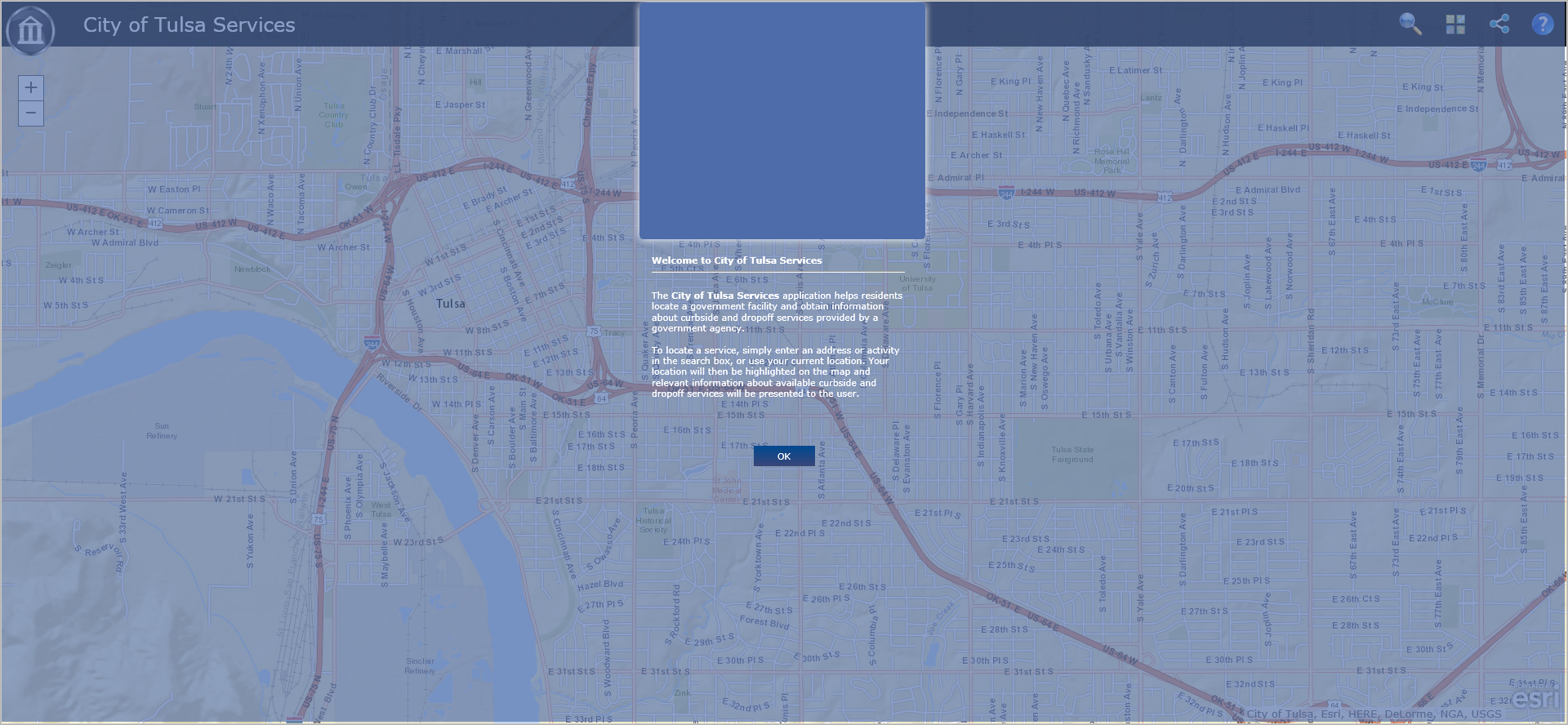

I've submitted a bug / issue in GitHub already but I'm needing an answer / solution quickly so I'm posting here as well.
The problem is the app splashscreen is broken in IE 11.
2015-08-12_073453.pngIE is the City's standarized browser system and as such we really need this app to work in it or else we have a problem. We use Chrome (and FIrefox) for development to ensure browser compatibility, but it works in those browsers. (technically I haven't checked in Firefox yet, but it works in Chrome)

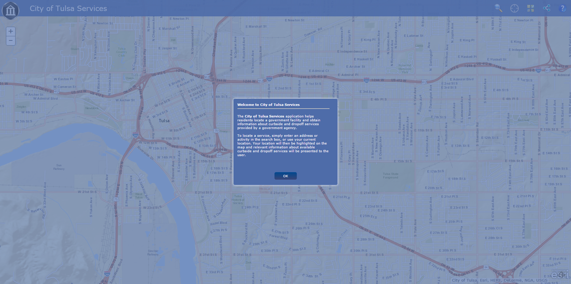

What I see in Chrome is as expected.
But IE (see version image above) shows me this...
Which, I believe, is not the standardized nor expected option. lol
Does anyone have any idea(s) on what could be the problem or solution?

A fix was discovered for this.
<meta http-equiv="X-UA-Compatible" content="IE=edge" />
This has to be the first element inside of the `<head>` tag.
It has to do with Compatibility Mode.
