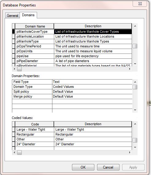

I am working with the Local Information Model for ArcGIS 10.2.  I am trying to modify one of the domains of the model.  I go the properties of the main file and then look for the domain which in this case is piManholeCover Type.  I am able to add it to the code and descripton, but once I get to the edit portion in ArcMAP is does not give me the new fields that I added to the domain.  I need the 24" Diameter.  Any suggestions?
