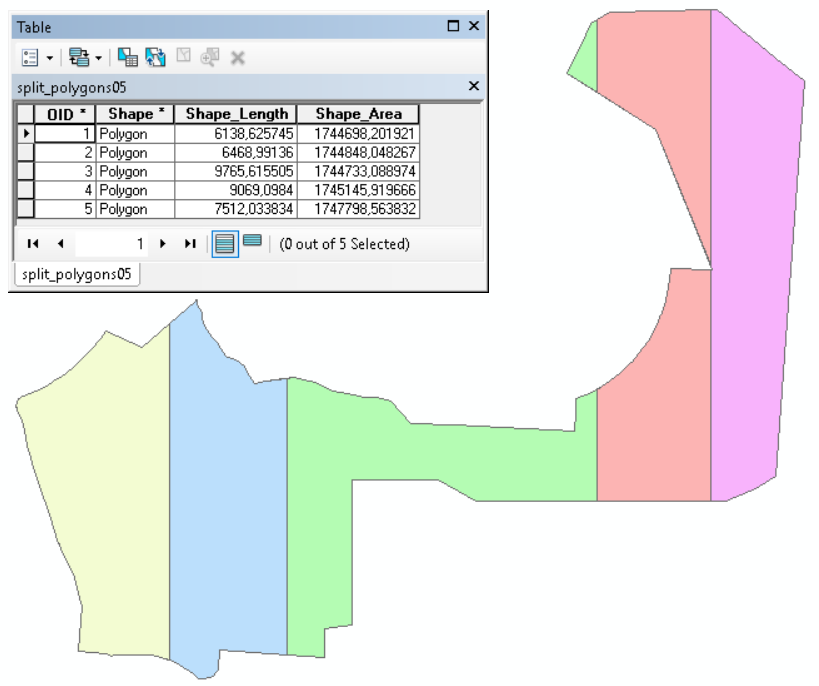

This results in:
... including a multipart polygon (in green)
