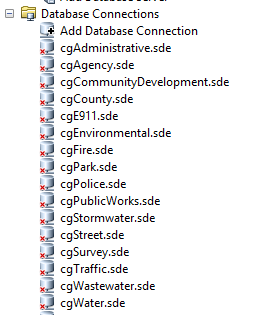

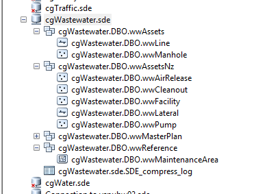

I punted.  I thought this might a question that a lot of us are struggling with - not so much.  I also didn't like the local government model.  If I have do any thing to one area of data it affects everything.  What I ended up doing is geodatabases per division ie public works, community development and also utilities ie water, wastewater, stormwater, transportation.  They all sit on the same server and instance of sql.  I don't do replication or currently have a test site.  I need get that up and testing.  Secondary programs that attach limit how that can work. I am including a screenshot of how I set it up.  Now I would like to work on creating some basic data schemas to share with folks that are in cities - seems to be a big hole.  I also included a screenshot of wastewater - the Assets and AssetsNz are for grouping those assets that are z and m aware and are used with an arrow receiver for high accuracy data collection in collector.  And so that I can set up some topologies for QA/QC
