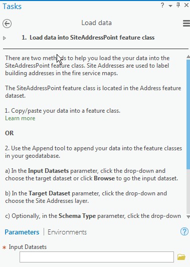

Hi guys, a mapping newbie/volunteer fire officer here.  I'm attempting to create a fire run book using the "Fire Service Maps" add-on on ArcGIS PRO 2.2.  Some really basic stuff is stumping me already.
I did procure parcel outlines and Streets shapefiles from the county, but I don't know when/where to use them.  I'm going through the tasks and I'm at "Load data into SiteAddressPoint feature class".  Here's what it's giving me the option of doing:
Instructions from task pane
I suppose I could just forge forward and try to see if the streets shapefile is able to be pulled in here, but I thought it'd be better if I asked first.  And when should I import the parcel outlines shapefile?
Sorry for the newb question.  (And I'm sure I'll have more to come!)
Thanks!

By Fire Run Book, I assume you are creating a map book of your area of response, correct?
A brief GIS primer first:  geographic entities are represented by one of three basic shapes: Points, Lines, or Polygons.  It sounds like the addin/task is asking to represent your site addresses as points.  Your streets are obviously lines and your parcels are polygons.
Contact your county and see if they have actual address points.  These are simply an x,y location with the address assigned to them.  If your parcel polygons have a location or site address field, you can convert them to points: every polygon has a centroid location to it.  See Feature To Point—Data Management toolbox | ArcGIS Desktop .  The difference is address points typically represent the location of the actual residence, whereas the parcel centroid 'floats' somewhere inside the parcel.
That should just about do it....

And prompted by your response, I looked in the folder containing the parcels shapefile (procured from county government for a reasonable cost!) and found a .dbf file.  I opened it in access and I found a plethora of information about each parcel- like a couple hundred columns  .  First column is the "Objectid" (which I assumes matches up to some sort of ID in the shapefile).  Also (of course) included are LOC_NO with the numerics of the address, and LOC_STR and its companions LOC_SUF and LOC_SUF2.  So at this point it seems (wild guess edition) that I can just point the task to the DBF and I'll be able to map the LOC_NO column into my target dataset?  But now thinking it through I don't yet have a shapefile loaded to correlate the objectids of the shapefile with the objects in the .dbf....hummmm

A 'shapefile' is actually a series of files, one of which is <shapefile_name>.dbf.  It's often referred to as the attribute table.  More GIS 101: there are two components to the data.  Geometry (point,line,polygon) and the attributes.  Attributes are the I (information) of GIS.
The dbf table will not be enough to satisfy your needs.  You need points as well....

OK, I looked deeper in the .dbf.  It appears as if the .dbf has no direct reference to the point.  There are these things called SHAPE_STRe and SHAPE_STLe that I think point back to the objects in the parcels shaepfile.  I wonder if there is any kind of routine that would interrogate the .dbf and .shp and can kick out point data??
Or is this something I need to go back and ask the county GIS guys about/for?  They do list "custom programming" services when we order the data- I wonder if this was something we needed to ask for up front?  Or maybe since they know that data they have a way to generate the points...
BuckySwider
Duh, it seems like that's the routine that you linked me to in your first reply!  Let me go off and investigate (and hope I'm licensed for that...)
