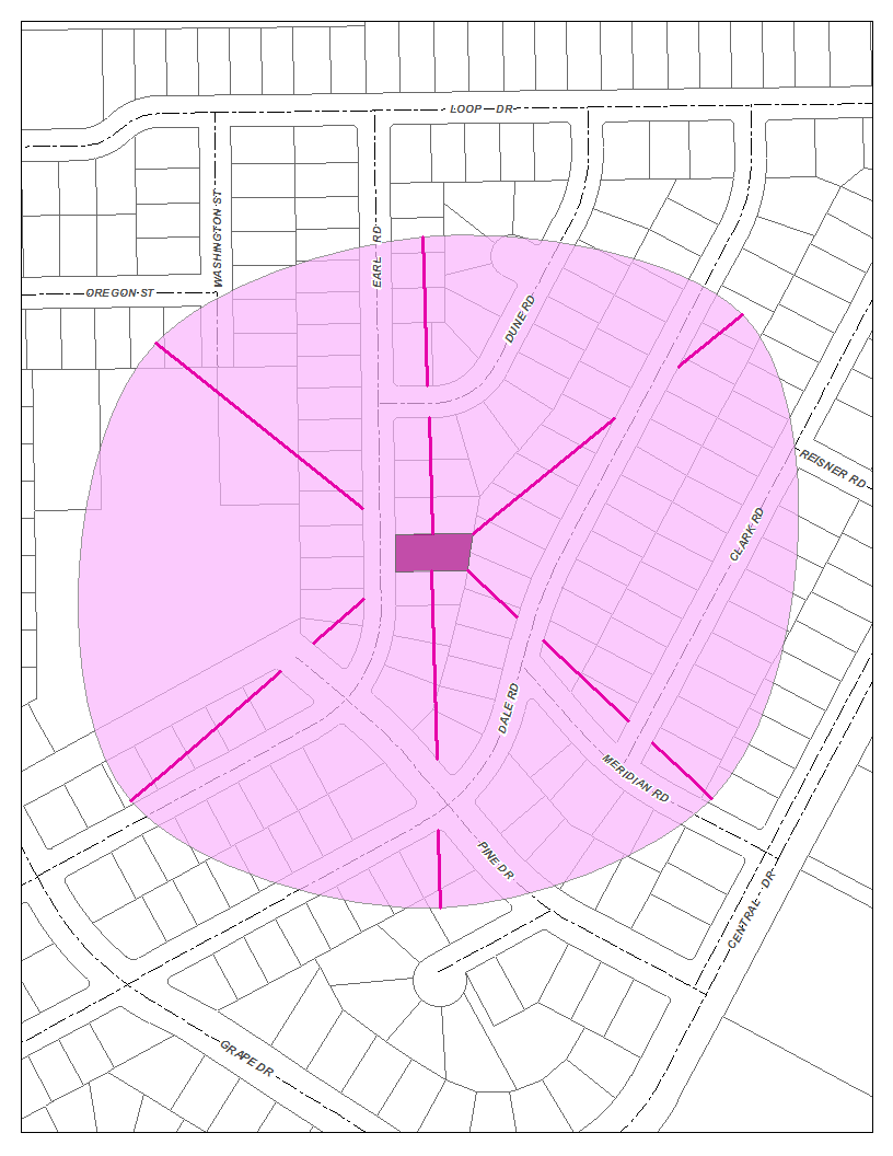

Here's my basic idea: I drew 500' lines radiating from the parcel. Then I broke out the parts of the lines that crossed a road and added them to the end of the line. I drew the buffer by just connecting the endpoints of the new lines and smoothing the resulting polygon.
Basic idea for exclusionary buffer.

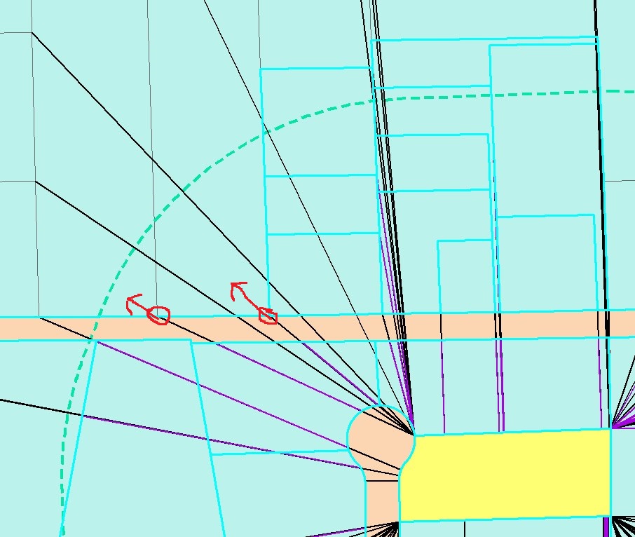

If you have an Advanced ArcGIS license, here's most of the workflow.  However, note the very last step (#6) needs some work still.
1.  Select your parcel to do the notification from and save it as a separate feature class.
2.  Run Generate Near Table (note:  requires an Advanced ArcGIS license)
  • Use a search radius like 1000ft to ensure it captures parcels but does not try to do all the distances to every parcel in your database.
  • Change the default checkboxes:  Location should be checked, Angle should be checked, Find only closest feature should be unchecked.
http://pro.arcgis.com/en/pro-app/tool-reference/analysis/generate-near-table.htm (this is the Pro help, but the ArcGIS Desktop help is the same).
3.  Run XY to Line using the table created in Generate Near Table as the input.  This will generate a line feature class.
http://pro.arcgis.com/en/pro-app/tool-reference/data-management/xy-to-line.htm
4.  Create a feature class of just the Right of Way (ROW) polygons in the vicinity.
5.  Run Erase (Analysis) (requires an Advanced license) to remove the ROW from the lines, leaving only lines across parcels.
6.  First, calculate the distance of each line.  Then find the ones that are 500 feet long or less and save them off as a separate feature class.  Then use a Select by Location with this Line feature class to select the parcels that qualify.  *****However, the Select by Location did not successfully find parcels just across a Right of Way, so this last bit needs work.***** (somehow part of the line is getting dropped, so of course there is nothing to use for a selection).
There may be a few other kinks to work out, but I think this process would work.  Once it is workable, one could probably use Modelbuilder to automate it, or even better, Python.  For the latter, we'd need some of the experts in Python to weigh in (not me).
